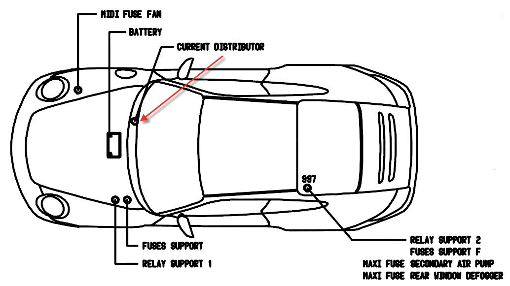

I was replacing the bulb and while replacing the metal shade/cover inadvertently shorted the terminals!
Result. No power to the lamp.
I can't find a blown fuse, all other lights etc work.and no reference to any interior lights on the fuse map in footwell.
Is there another fusebox....or have I missed something?
Yes, naturally I can see the red arrow, but it is pointing at the top of the dashboard.....
Do you know where it is?
I would be really grateful.

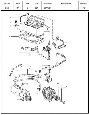

The 80 amp fuse is near the battery. Looks
like part 11 in the picture.
The glove box is a 3 amp light. I would look for a
small fuse on the wire to the light.
Good luck with your search.

Hi Paul,
Many thanks for your reply.
I have looked for the current distributor (11) that is nicely displayed on the + ve cable from the battery in the schematic. The lead dissapears into the bulkhead.... Luck is certainly what is needed!

Hi, Here is an update, just in case anyone else has the same problem.
in shorting the bulb, it must've blown the micro switch.
Replaced the switch and bulb holder loom and all is now working.
