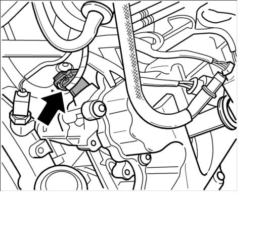

Yes at the rear of the camshaft - near the position sensor.
These can easily be damaged by someone removing or replacing the camshaft cover.

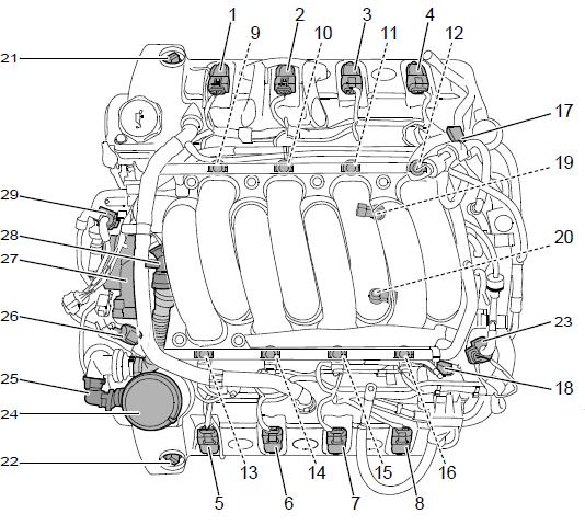

I think you missed my point - the diagram shows bank 2 is the left side of the car (drivers side for US/Canada cars).
Do you get the exact same fault code (P0439) and no other faults?
