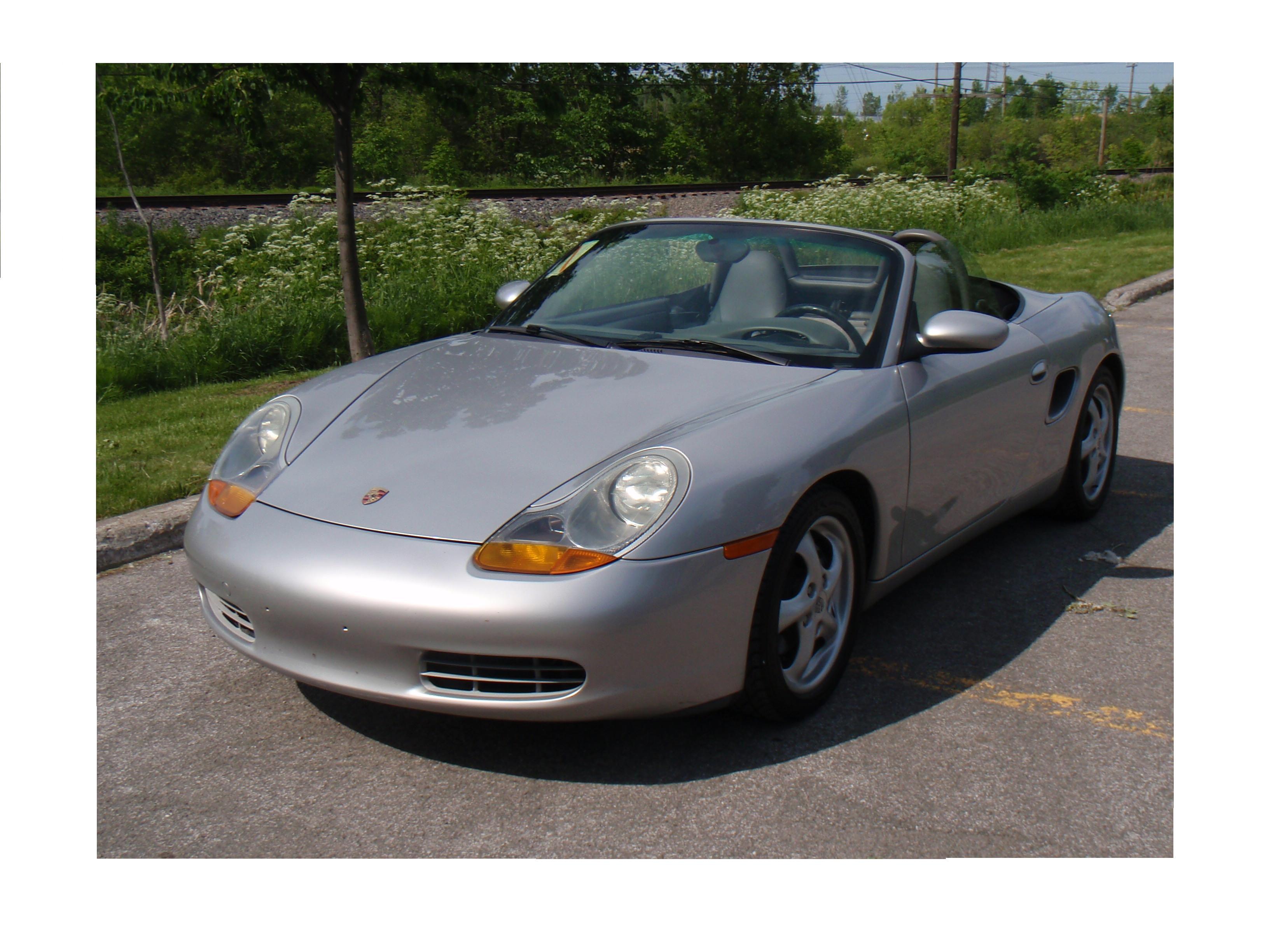

I did try to attach a pic of my ride, but file too big, so I'll try to take a more "light" pic this week end.

Hello again:
Here's the pic of my 98 Boxster!
Finally! Regards
Fermin
