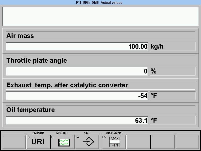

You will need to check throttle position response using Durametric, PST2, or PIWIS tester.
