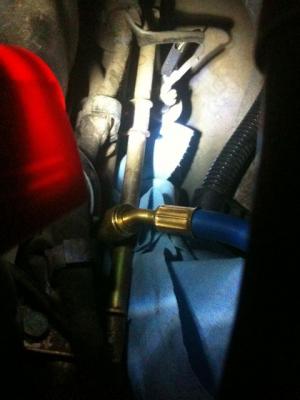

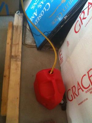

I really wanted to check the fuel pressure so I spent most of the day trying to acquire a guage that would work. I took the cap to my local ACE hardware and found that the only bolt that would fit was a 7/16-20. None of the metric would work. I bought a bolt so I would have something I can check connections with without trying to hook it up to the car. I went back to my HF fuel pressure tester that I hadn't taken back yet and sure enough, the GM schrader connection screwed right on. So, I took that out to the car and attempted to connect it. The problem was that the valve/seal on the connector were too shallow and I couldn't get it far enough on the test port to catch the threads. So, I gave up on that and took it back to HF. In the end, I had the solution in my garage already in the form of the HF AC service kit (item# 92649). The low pressure side has the correct pressure range and the fitting was a lot deeper and caught the threads and made a good seal. I also connected the yellow service line to the gauge assembly and put the other end in a gas container. It worked like a champ (pressures were to spec) and you just turn the service knob and the pressure is released through the yellow service line into the gas can. Obviously, I am not going to be using this for AC service but it will only cost me $40ish dollars to replace. I attached some pics...
