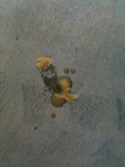

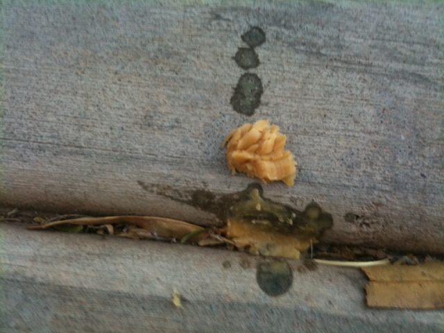

PKN and Deilenberger,
Please help - I found these (two) under the Cayenne after the drive back home. Phoenix is a sweltering 118F today and my drive home from work, was a 16 mile commute with a couple of stops.
The drip doesn't smell and feels greasy. It was on the concrete and must have dried up quickly.
The car had 66,157 when I bought it on Saturday. I looked up the records and the coolant assembly (from plastic to metal) was changed at 66,010 (6 months ago - yep - this 2006 S was sitting in the garage cos the seller had bought a 2011 S) and the 60k mile service was done last July at 59,000 at the local dealership. As per my PPI, no leaks were detected and all fluids looked good.
Never seen this under my 2000 Boxster S, even though it has had coolant leaks in the past.
Any idea what this could be?
post-62596-0-85017500-1309230551_thumb.j
post-62596-0-39486000-1309230565_thumb.j
Edited by shyster77
If I had to guess - it's something that was on your driveway before you pulled up in the Cayenne..
I can't think of much of anything in a vehicle that would look like that..
Looks like it might be Waxoil or some other cavity protectant? Had similar looking stuff drip out of my Passat years ago and it was protectant. Hard to say from a picture though.
Thanks, deilenberger, I was suspecting the same - at least from the PPI - no drips were found.
Interesting, CdnRD - I will be on the lookout - it certainly felt waxy, now that you mentioned so.
