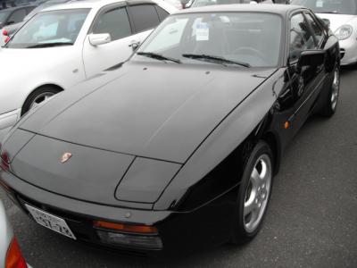

Today i became the proud owner of 2 porsches, my second one being a 1989 944 automatic 3 speed tranny.
Some known issues about the car:
original Engine caught fire, another engine was sourced from a same year model. both Japanese origin cars.
current chassis number is WPOZZZ94ZKN401651, when i use Scouser's Vin Decoder it shows the car had the 3.0L DME Engine.
The donor car's Chassis number is WPOZZZ94ZKN404260 which shows that the engine was a 2.5L DME Engine... i thought 89 models did not get 2.5L engines!?!
Now the previous owner of the car says he's sure it's a 2.7L engine... i tried to check the engine number but could only find the crank case number 944.105.250.7R
89 model 944 cars should have the engine number on the rear right hand side of the engine, but i couldn't find any other code.
2) the car vibrates a lot when idle and when in reverse gear... i read about rough idles on 944s, but this one shudders bad, not sure if it's normal.
3) when on the highway cruising, there's a rattling coming from under the shifter area, sounds like it's coming from the tranny..
i expected the car to have some issues, i'm just hoping it's nothing major like a full transmission change.
any feedback on the above would help.
