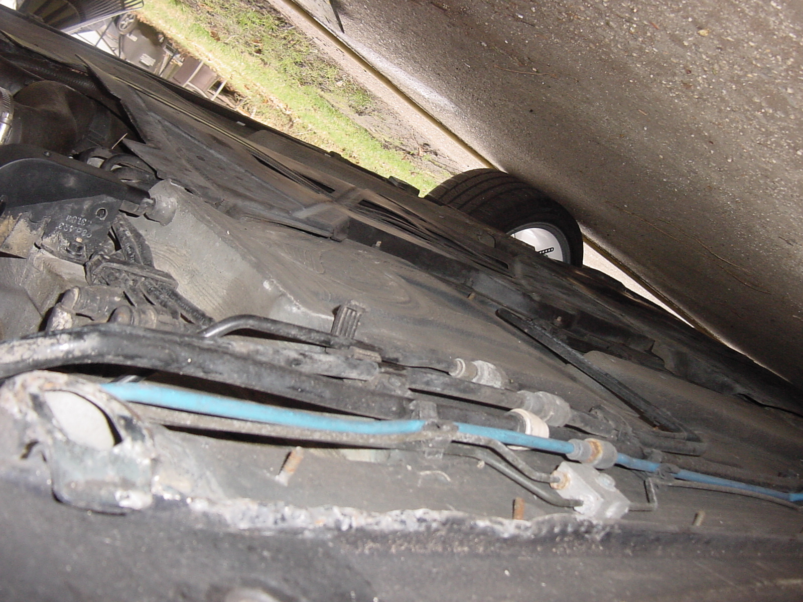

Yesterday my clutch stuck to the floor and I had to have the car towed. Jack the car up and there was a leak in the clutch line right under the driver side. The line extends up into the right wheel well. Just a few questions. Is this line difficult to replace? Should I bleed the entire system again?? (Hope not :unsure:) The fluid in the reservoir was just below minimum...Any help or input would be appreciated. Thanks!
Here's a pic courtesy of Maurice :cheers:

You should only need to bleed the clutch. Although the clutch shares the brake fluid reservoir, for safety reasons the take-off pipe for the clutch is higher up the reservoir so that a clutch leak will not empty the reservoir, so won't affect the brakes.
