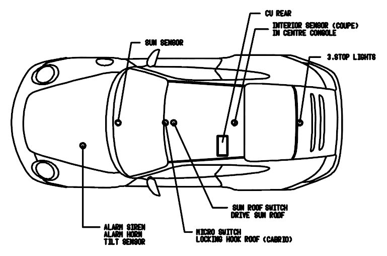

In the 997-1 they changed to PAS (alarm/locking) the PAS unit got mounted under the dash near the steering column. The control box under the left-hand seat is the rear control box.
post-1-0-10131700-1307022470_thumb.png post-1-0-24953600-1307022471_thumb.png
