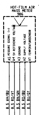

After searching through these forums for similar symptoms, my best bet was to look at the MAF. To my surprise, the mechanic replaced the MAF with another one that wasn't even meant for a Porsche. My guess is the harness for the MAF didn't fit this replacement, so he just cut it off and connected the wires directly. I already ordered a new MAF but I need to know the correct way to wire it when it arrives. Does anyone have photos, a schematic, or color code that can help?

So I finally got the new MAF. Can anybody help me with this? Maybe just taking a picture so I can see the wire colors?

Ok so I disconnected the battery, connected the new MAF according to Loren's schematic, and reconnected the battery 5 minutes later. I've driven the car for a week now and it feels worse than when the MAF was not connected. If the engine is cold and I press hard on the accelerator, the engine stalls and almost turns off. Additionaly, most of the times I do this I hear backfiring. I disconnected the MAF and everything works fine again. How can I fix this? I have the Durametric cable, is there a specific measurement I should check? Is it a good idea to be driving without a MAF?
