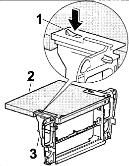

You have to remove the cover and central vent from the dashboard first.
Then press the metal clip and hold while pulling the cup holder out of the retaining bracket.
