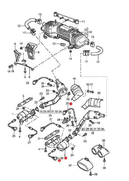

thank you kbrandsma,
so, it is on the passenger side. can you please redefine the behind catalytic converter location of the sensor ( is it front or after the starter catalytic-converter. Is there a picture of which one is which? sorry to ask but I am very new to this.
Here is a photo of your stock exhaust. On each bank there is a manifold that leads to the muffler.
The red dots identify the pre-cat(before) O2 Sensor (#26), the catalytic converter(#2) and post-cat (after) O2 Sensor (#25). The red dots are on the driver's side manifold.
