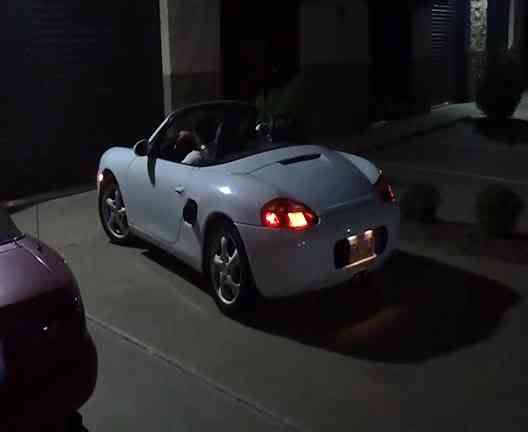

you can view the video of the car idling without exhaust just the downpipe. getting it to the muffler shop so i can get some exhaust worked on. i drove it around, feels good so far.will post up pix of me driving it. I have to reiterate, the cluster was not done completely yet, the coolant gauge, the fuel gauge and the speedometer was the only ones working in the video, the rpm didn't becuase i forgot to tap the signal wire into the crank sensor. The second shifter was to test my diodes and gnd trigger wire to each shift solenoid to make sure that each gate i put that shifter in did not send gnd back into another solenoid by soldering in diodes. once i have that sorted out, I can use a computer shift box and tap it into my steering shift button to control my up and down shift accordingly. "at this moment road surge only has 3 speed" waiting for the 4 speed set up.
