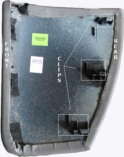

It helps to see the back of the side panels to know where to pry:
This is the driver's side panel of my MY2000 996. As you can see the 3 clips are in the back. There are 3 little clips in the front of the cage that fit into the grooves in the front of the panel.
To replace align the cage clips with the grooves in the side panel and snap the 3 clips on the back, and Bob's your uncle!
