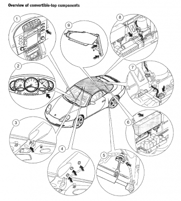

Can someone tell me where all of the mini switches are located for the 996 2001 convertible top function? Is there a diagram somewhere? Thanks
1 - Rocker switch
2 - Warning light
3 - Micro-switch, latching hook (windscreen frame)
4 - Micro-switch, convertible-top latch (convertible-top side)
5 - Potentiometer, convertible-top interrogation
6 - Control module
7 - Micro-switch, convertible-top compartment lid (locked)
8 - Potentiometer, convertible-top compartment lid interrogation
9 - Micro-switch, left/right rear section flap up and down
The convertible top is actuated if:
- Terminal 15 is connected via ignition.
- The parking brake input is connected to ground (parking brake engaged).
- No speedometer signals greater than 5 km/h (3 mph) are present.
- Engine compartment lid is closed (input not at ground potential).
