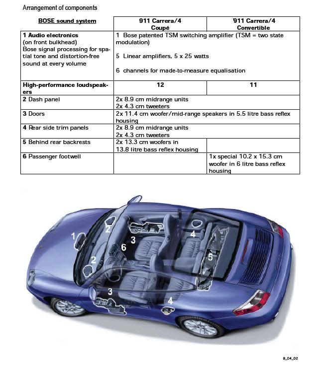

I'm currently looking to buy a 2002 996 Carrera 4S and plan to get the audio system redone. Before I go shopping around I would like to get the exact dimensions of all 6 speakers in the car and what I might be able to upgrade each of them with. I will be looking to replace the Amp, all 6 factory speakers and the deck. I have checked a number of sites including Crutchfield and have been unable to get this information. I have been looking into getting a Hertz / Audison Speaker and Amp system installed with likely a Kenwood Double-DIN Nav system. Any Information / Advice would be greatly appreciated. Thanks and have a great day!
This may help:
