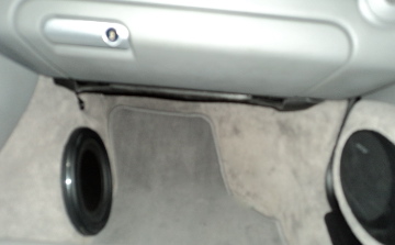

do you have any pictures of the foot well sub in your car?

I'll take some pictures of the footwell sub and post them - it's hard to see because it's black to match the interior.

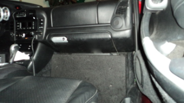

Pictures of:
1.) The footwell sub enclosure in my Boxster
2.) Rear Bose bassbox in Boxster

The footwell in the Boxster takes some room from the passenger's leg room but since I rarely have anyone except my son or wife in the car, it's not a big deal. If I had it to do over, I'd probably go with a shallow mount sub in this area (like the one I had fitted into the turbo's bassbox) to save room. I've also seen a footwell enclosure for the Boxster that fits on the side like the 911 turbo cabriolet. That would probably be the best in terms of overall leg room for the passenger.
Ultimately I'd ping ALBERTQ17 to see what he's got. I saw in the post I referenced above somebody was asking about rear speakers added to the custom bassbox he did. Assuming you could get it all together, I'd go that route so you don't have the lost leg room. Even though I upgraded my Bose bassbox in the rear, I still like the thump a 10" subwoofer can hit with; which is why I have both in my car.
