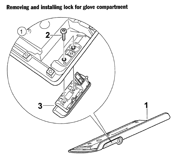

This article was very helpful. Is there any guidance available in swapping the glove box latch lock from the broken part to the new part. My is an 03 996 C2 Cab. Any guidance would be appreciated.
Loren,
Thanks for the prompt reply. I am brand new to this forum. I am already in receipt of the link provided. Where I am looking for guidance is how to remove the lock assembly from the latch assembly so that it can be installed in the new replacement latch assembly. Is there any available guidance on this item?
Thanks again,
Shawn
Loren,
Thanks again,
Shawn
Here you go...
(click to enlarge)
