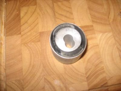

The lower control arm has two bushings - one that is about a third of the way back to which the transverse control arm attaches, and one in the rear where it attaches to the suspension subframe.
I have attached a picture of the bushing for the transverse control arm. I have somewhere in my garage the rear bushing, but I cannot find at the moment. It is same except it is skinnier and longer - more cartridge like.
You can see the rubber is attached to the outside cylinder in two places opposite of each other. If this were installed, the bushing would not have the oblong shape, and you would be able to see through some in the thin spots. But not in the two big, beefy spots.
You are looking for torn, cracked, dried out rubber. You may have to lift the corner and apply pressure in various ways to see if there are cracks. Unfortauntely, a thorough inspection, one with 100 percent certainty, you might need to remove the control arm. Alternatively, if you feel any play where the control arm attaches to the subframe, and the bolts are tight, that would tell you the bushing is likely shot. Same for play where the transverse control arm connects.
If you find they need replacing, you do not have to replace the whole control arm - you can get replacement bushings and press the old out and press new ones in. But look at the rubber boot are the ball joint too - see if it is torn. If it is torn, you might want to go with a new arm.
A stud at the top of the strut passes through a rubber bushing of the same design. If it moves, the bushing is probably bad. Strut mounts are not terribly expense. The steering bearing probably would not make a clicking sound. It is just two pieces of shape rubber/plasic with small ball bearings in between to allow the strut to more freely rotate with steering angle.

Wow, thanks for the quick & thorough reply!!
Looking at your bushing image, mine looks the same, the rubber isn't completely surrounding the inner bearing.
All the rubber joints look good, just dirty. I think I'm going to change the shock mounts first, whilst on leave, & take if from there.
