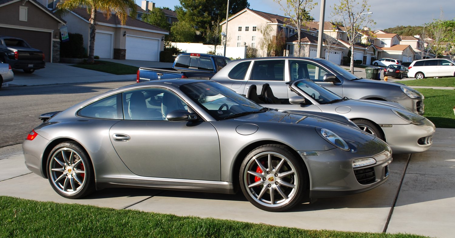

Here is what I experienced with my 06 Carrera 4S face lift project. I just turned 40 this year in February and it was a great time to do a little something special for myself, or atleast that's what I told my wife :thumbup:
I wanted to upgrade the look of my C4S and the 2011 Carrera GTS, Speester, and sport classic came out from Porsche and I absolutely love the new Sport Design front bumper.
Since I have the wide body C4S I also added the GT2 side skirts that are also on the GTS,Sport Classic and Speedster.
Like you, I wanted to freshen the look of my C4S with new LED lights as well, which turned out to be quite the nightmare to research. Do you need a computer, what is the wiring diagram, what parts are needed, etc, etc???
Nightmare to find answers and a lot of people wanting to charge you lots of money to give you the answer... but now that I know it is not so bad executing if you have a good indy mechanic or are resourceful and can handle a wiring diagram and splicing.
IF, IF you are ONLY doing the FRONT LED upgrade and bumper... you DO NOT need a new control unit for the lights....
IF... IF you are planning to upgrade the REAR tail Lights to LED and bumper... then you WILL need a updated control unit.
For the FRONT LED upgrade we just had to modify the wiring harness that runs to the front turn signals and fog lights. You must order the 2009 LED "Mini Loom Cables"... 2 qty (L+R)... These mini cables are about 12 inches long and are the new wiring and plug that go into the updated LED turn signals. They will need to be spliced in to your existing turn/signal/fog light wiring harness that runs the entire length of your bumper.
Your existing MAIN cable plugs in just behind your passengar head light. the cable then drops down and runs along the entire bottom of your front bumper all the way to your driver side side marker light.
Along the cable you will see where there are additional wire cable looms that branch off to your turn signal/ fog light. It is those wires to the turn signals that you will have to basically cut and remove and then splice in your 2009 LED mini loom. Your old turn signal has 3 plugs /wires that feed into it for turn signal, fog light, and parking light. The New LED loom is only 1 plug that handles all three function. All the voltage conversion for front LED light is handled inside the new LED turn signal automatically. I have a great indy mechanic and he was able to get the wiring diagrams for the new LED mini cable loom as far as which wire feeds the fog light, turn signal and parking light. There is only 1 ground wire in the new LED cable loom, so your 3 grounds wires of old mini loom will be handled and spliced onto 1 now with the new LED mini loom.
You will need to be resourceful and get your hands on a diagram or have your indy look into to which 3 old "power" wires match up to the 3 power wires of the LED. Once that hurdle is done and the new cables are spliced in
it is just plug in as usual.
NOW... LED's work by turning on your parking light and this turns on the thin LED light. Pull your light knob to activate "fog lights" and now you get thin LED light PLUS Lower line of lights to give that really
nice and bright LED effect. If you have Sport Chrono pkg, then you can go into your settings on the MAIN nav/radio screen and there is a "Memory" section that has the "daytime running lights on/off" check box.
You can check that on, but your headlights will be on as well. I just use the parking light switch and pull for fog light to have that cool LED daylight running, but with no headlights..
OK, so that's all you need know for front LED's wiring only ... NOW all the parts you will need for doing the Front bumper conversion..
-2009 Front Bumper or Sport design bumper
-Lower lip spoiler for design bumper/ or plastic inserts on regular 2009
-Middle air deflector for "center mouth opening". Be sure to check if you have a center radiator for Automatic cars. PDK cars have center
radiator, so the mouth/center shroud is different for Autos vs Manual, but maybe not on 997.1 . 2009 Manual cars have just a center air deflector "wall"
that routes air to the L+R new radiator shroud. PDK cars have an "OPEN" hole that feeds air directly to center radiator.
-Left and Right updated radiator shrouds , much bigger- Old radiator shrouds too small..
-L+R Vent Grills. They also double as the LED mounts and washer nozzle holders Unit.
-Left and Right updated Led turn signal lights-
-2 mini cable looms to run to L+R LED turn signals
-Left and Right updated headlight washer nozzles- If you have head light washer.. old nozzle units will not plug into new LED Grill Unit.
I hope this helps. Price wise... I ordered everything from Luke at Sunset Porsche for a good price. Figure approximately $2500-3000 US for parts and then
whatever you can find for painting. Plus keep some money a side to pay your indy mechanic for saving you a lot of trouble and doing the wiring for you :help:
They are smart and work hard... It will be worth it. Here are a couple of pics of my 2006 Carrera 4S with facelift. ...

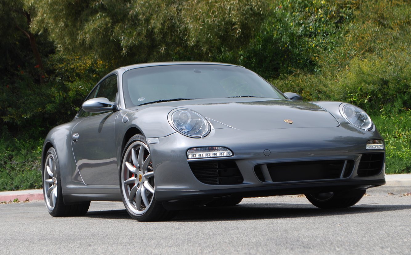

I have the exact year, same color C2S as well. I purchased the aerokit front bumper (which is a bit different) and plan to put a front and rear spoiler to bring it to a 997.2 Aerokit look. Also will be buying the mirrors and turbo 2 wheels afterwards. Hope the result turns out to be good. I forgot to mention the dynamic cornering headlights ( just for visual I know the cornering wont function) .
