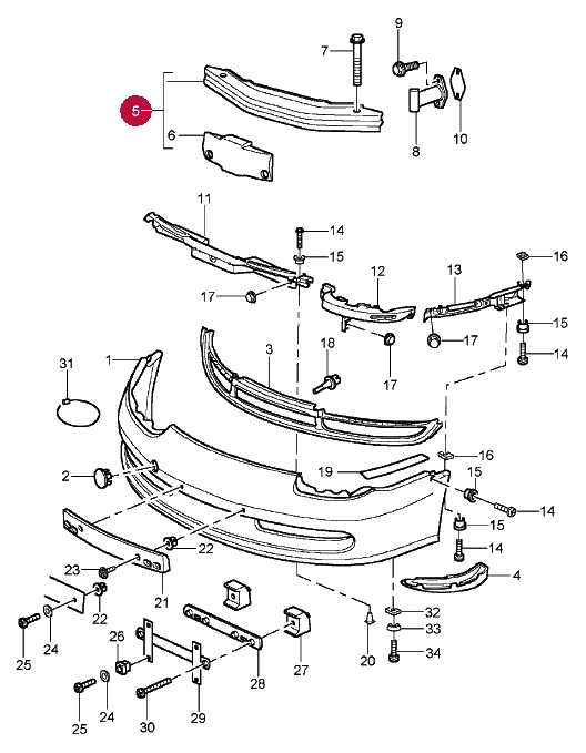

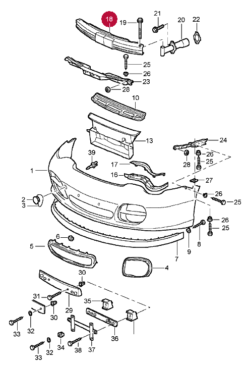

A GT2 bumper (or Turbo bumper) is not plug n' play on a narrow body car.
At least the bumper reinforcement needs to be changed or the 996 one cut.
See the differences below - 996 left -- 996 gt2 right
post-1-0-18744900-1302442922_thumb.png post-1-0-63771800-1302442926_thumb.png

Ahh..I see now. Ok thanks Loren.
