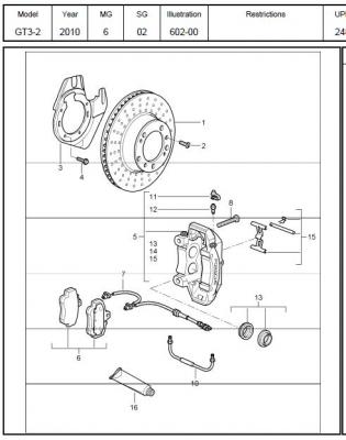

I need some help! I purchased new front pads for my 997 GT3 and do not understand how to remove the old pads. The pin which secures the pad expanding spring appears to be threaded and does not match the assembly depicted in the forum's pad change procedure. Anyone have experience with this issue?
Here is a picture of a 996 GT3 brake pin. It looks standard with the
circle clip to hold it on. I would phone Sunset Imports and ask
the Porsche guy if the pin is standard. See part 15.

Thanks for trying. The drawing does not describe my 997 GT3 brake pin, which does not have a circle clip.
That pic is the rear cliper.....996/997 are different
Front pin has a bolt in the end of it. Unbolt & knock it back out.
