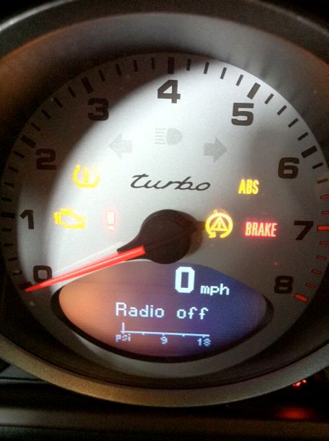

I have a 997 turbo and my boost gauge indicates psi marked 0 9 18. The dealer says it is really bar, although. there is no decimal point in the 18. What should it show? I suspect I'm not getting full boost, but they're saying it's ok, based on the gauge indicating bar, rather than psi.
thanks

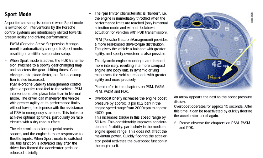

HI..
Yes, It will display regardless of what display mode you have. Just have to press the "Chrono" button, and jam the gas all the way, quickly. ( I am assuming you have the Sport Chrono Option?) If not, sorry to confuse you.
To the right in the center display. And it does display for just 10 seconds. I attached two images from the Owner's Manual to indicate what we are referring to... Hope that helps.
DC

Hi + thanks
My car is a 997tt 1st gen with sport chrono.
1. Where is the "Chrono" button? ? I dont have such button, only "Sport"
2. I think the images you posted are from Gen 2 Owners manual because it refers to PDK etc
"Hi + thanks
2. I think the images you posted are from Gen 2 Owners manual because it refers to PDK etc."
Yes....It is Sport Chrono....But the button just says" Sport".
Yes...The manual is from Gen 2, but the info about the sport overbost, arrow etc. is the same.
DC

Yes I see the arrow now. Very easy actually...

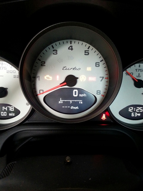

So which gauge is normal and why does Porsche have 2 different gauges in the same year 997 TT ('07)
