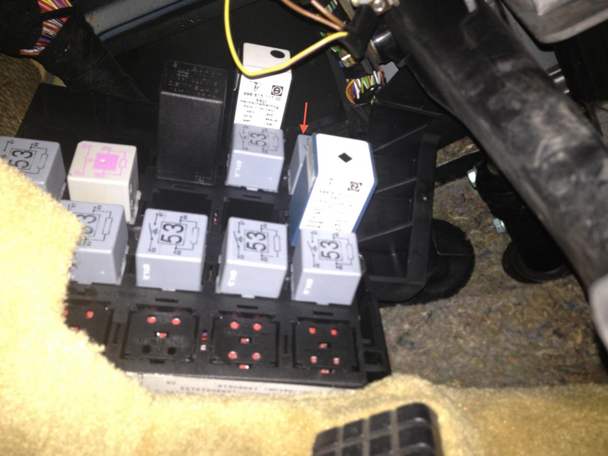

Can someone please indicate where the turn signal relay is housed. I bought one to eliminate the hyperflash of the new LED bulbs and thought it was in the fusebox in the footwell. Nope, not there. Alas, i cant find it.
Relay position 3 - that would be top row - 3rd from the left.

yes, that is the relay box. As Loren says, third from the left...the big black one. Swap it out for the one that works with LEDs. I bought mine from superbrightleds.
Thanks. Though from Loren's description, the relay you refer to is not on the top row. I pulled it anyway, and replaced with the one from superbrightleds.com, and my lights still hype flash on turn signal. So to confirm, it is the large black one in the picture that needs replacing?Thank you,Keytohwy
Update - Jimmy3530 is correct, as per Loren's directions. The relay to remove cannot be seen in this photo (hence my confusion). The relay that was to be removed is behind the tall black one in the photo, which is to say, third from the left, top row. Replaced it and my hyper flash is gone.
