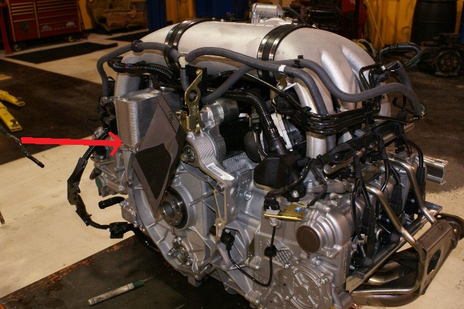

Good news if the puddle is directly under the oil filter.
If it's oil, it may just be the large o-ring seal on the oil filter, or that the oil filter housing somehow got loose or cracked.
If it's antifreeze, it may be coming from the oil cooler, which is on top of the engine, but almost directly over that area.
The oil cooler has four o-rings (two for the coolant passages, and two for the oil passages). I would check to see if it's any one of those, which would show up at the point where the oil cooler mates with the top surface of the block.
Here is a photo of the oil cooler on a 3.8 X51, with the arrow pointing to the mating surface:
post-6627-0-65680200-1301590179_thumb.jp
This should give you an idea of where to look.
