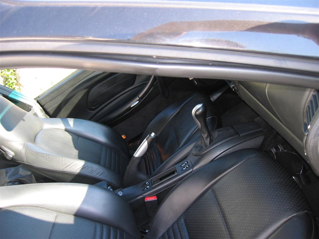

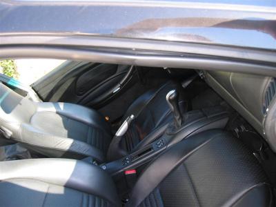

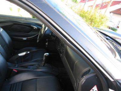

Here they are:
thanks, but i thought the pics might show exactly what they did so that i might consider doing somthing simalar mysellf as i cant seem to get rid of the noise as yet...and if it worked i would at least know what exactly is causing it!!
Here they are:
Nothing mysterious about it. Just insert a 10" piece of the grey rubber foam that is normally used to stop the rattle in the rear window between the overlapping lips of the door seal. If it works, glue it down. Done.

I am sorry to bring this topic up again, but I have the same noise coming from the driver side window. If you look at the attached picture:
The noise is coming from the point where the two arrows (A and B ) point. If I put my finger and push the rubber from the inside towards the window at point B it stops.
Now, I thought I should try the fix suggested in this thread but when I looked carefully I saw that my door seal already has a similar fix applied (previous owner?) but the foam rubber bit is inside the outer part of the seal (arrow A).
I am not sure, but I thought the correct way would be to insert the foam rubber bit in the inner part of the seal (arrow B ) - right?
Also, is the part marked "C" adjustable? Can I increase the angle with the door so that it pushes the seal more?
Yes , it should be in the inner part of the seal. Actually this is exactly the same location where my whistle came from so there's a good chance to fix it. I'd say its possible to adjust the door to give more pressure to that point but I don't think it's a good idea if the door's overall fit is okay.
