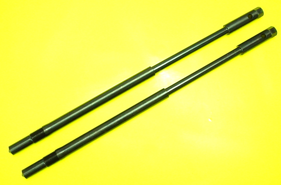

Anyone know where you can buy the special tool to suspend the caliper? Also when replacing the rear pads and rotors does the car have to be in neutral??? Are there any detailed steps on how the pads and new hardware kit are installed?
any updates on this?
Tool is actually a VW item and looks like this:
vw_matra_t10439.jpg  About $54 from Samstag Tools
Considerably cheaper from SnapOn - $32/pair.. https://vw.snapon.com/SpecialToolsDetail.aspx?itemId=16580009%C2'> They're showing out of stock at the moment. They were in stock about 2 weeks ago when I bought mine.
And I never thought I'd be putting "cheaper from SnapOn" in a sentence.. go figure. In general I found their prices to be better then any of the aftermarket tool places for the VW/Porsche special tools.
Thanks guys for the helpful info! Getting ready to purchase the front rotors and pads for our 13 Cayenne diesel,sourced from Sunset Porsche for $529. After reading this thread I'll also purchase those pins for $32. Thanks guys,keep up the great forum!

$32 is excessive?  If you drop one of the calipers and rip the brake line out - the cost will far exceed $32. If you drop a caliper, rip the brake line out and it ends up on your toe - the cost will far exceed $32.  You're going to save $300-500 over visiting a dealership.. and $32 is excessive?
Reread what he said: "I found the pins somewhat redundant if you have another pair of hands to help" - do you have another set of skilled hands around?
