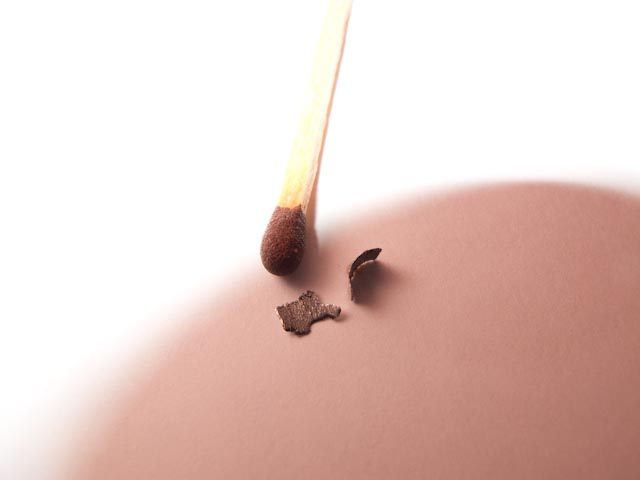

not sure if i need to put a separate topic. I have opened oil pan today on my 996c4s (2003) (50k miles) and found two metal flakes (not sure if they are aluminium but most likely they are Alu as one side is matte and othe is shining mirror). should i be worried? is there any way to find out where they are from?
post-20455-0-70837100-1301180683_thumb.j
post-20455-0-93149600-1301180697_thumb.j

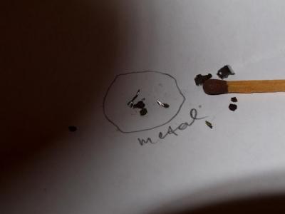

thank you. did that and here is the result. I also picked up few additional flakes form the filter. metal ones are very thin flakes (hard to take picture) and non metal ones are thicker
post-20455-0-33666500-1301258263_thumb.j

Obviously, it is hard to diagnose these issues “long distance”, but if you are indicating that the metal “flakes” can be picked up by a magnet, you have a serious issue that is not going to get better on its own. Without seeing the metal close up, I would have to say that it is probably from one of a couple of potential sources: (1) The IMS bearing. When these unit crap out, they tend to shed a lot of ferrous metal, usually as a granular material, but sometimes as flakes. If it is, you need to stop running the engine immediately as failure of the bearing will total your engine. (2) Something in the valve train such as a failing spring (not uncommon) or something in the VarioCam system. The non metal bits can be the cam tensioning “paddle” wear covers coming apart, but they can also be the IMS bearing seals breaking up as the bearing starts to wobble.
You need to get the car to someone that knows these engines well, and I would suggest not driving it there.
thank you for the advice. not many people around me that know the engine :( (plenty of people that "just get the new one" type). i am i right to think that engine needs to come off even for people that know them?
Depends upon what the problem is; the IMS can be changed with the engine in the car, as can a valve spring, although changing springs can be a bit time consuming.
(as the idiot who lost a bit of plastic tubing in the engine)...I'd go with the 'do not drive' recommendation. The tow cost can be claimed from your insurer.
Whatever the ultimate cause, driving this one to the garage is only likely to make it worse...take the tow!
