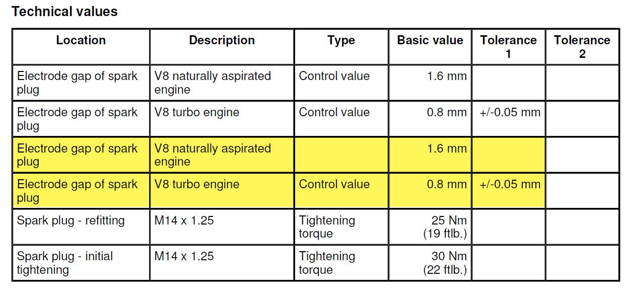

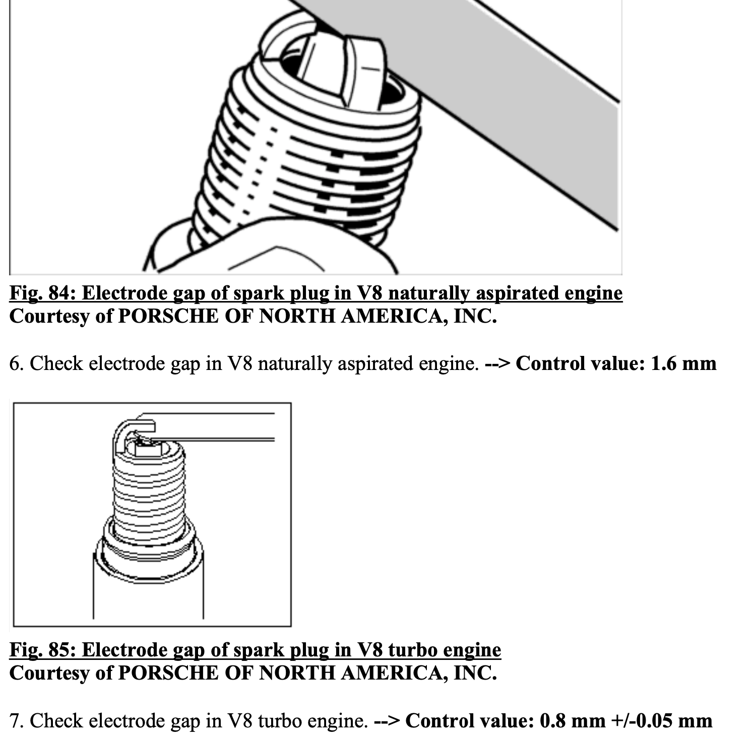

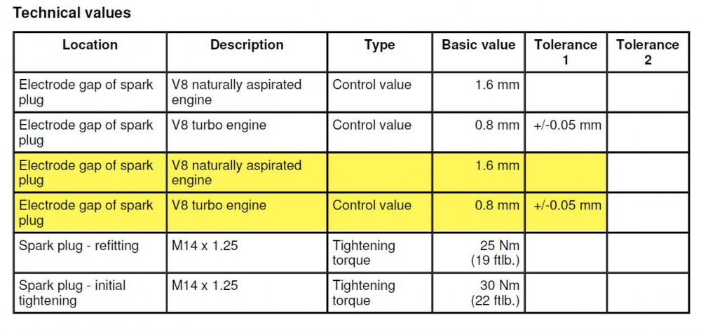

Loren said both the turbo and the NA V8 4.5L use the same gap. I don't think that is correct. Turbo is 0.8 (single electrode) and NA is 1.6 (multi-electrode). I sure wonder why they are different but that's for another discussion. 🤓🤓I also read somewhere that they are pre-gapped and just put my previous ones in the way they were. Didn't check. They were NGK iridium and the center electrodes melted off. Their literature says the ground electrode will fail before the center one does. Turns out that's not the case! So I'm going to try out the autolite double platinum. Close to OE for turbo. They say they use double platinum in OE anyway. Checked the gap for 0.8 (Turbo) and they were way larger. So I set them. Thanks for all the info on here!
