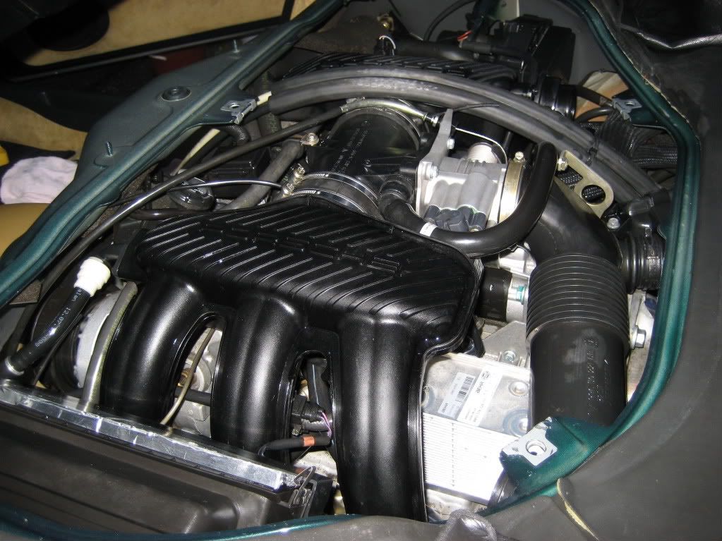

I think if you have a lot of slack it is not proper installed.
Perhaps one of the Boxster guys can take picture for you of the proper path for the cable.
Here is a shot. Not sure if it will help.
That is one clean engine if I may say so.

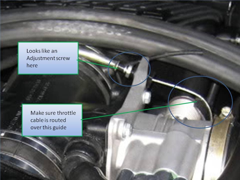

Check the two (2) circled items in the photo below.
Checked routing of the throttle cable, and it is identical to the picture provided (Thanks kbrandsma!).
What appears to be a adjustment screw in your picture above, is actually not, unless I am really missing something obvious here.
Where to look for next?
Joost
