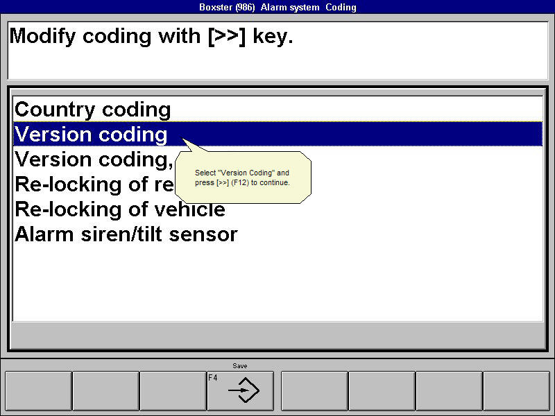

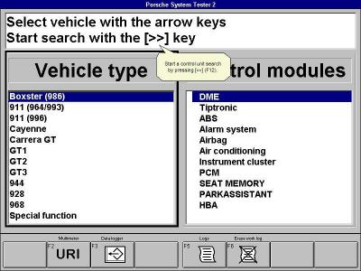

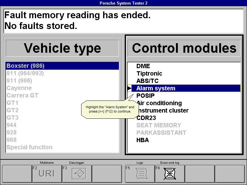

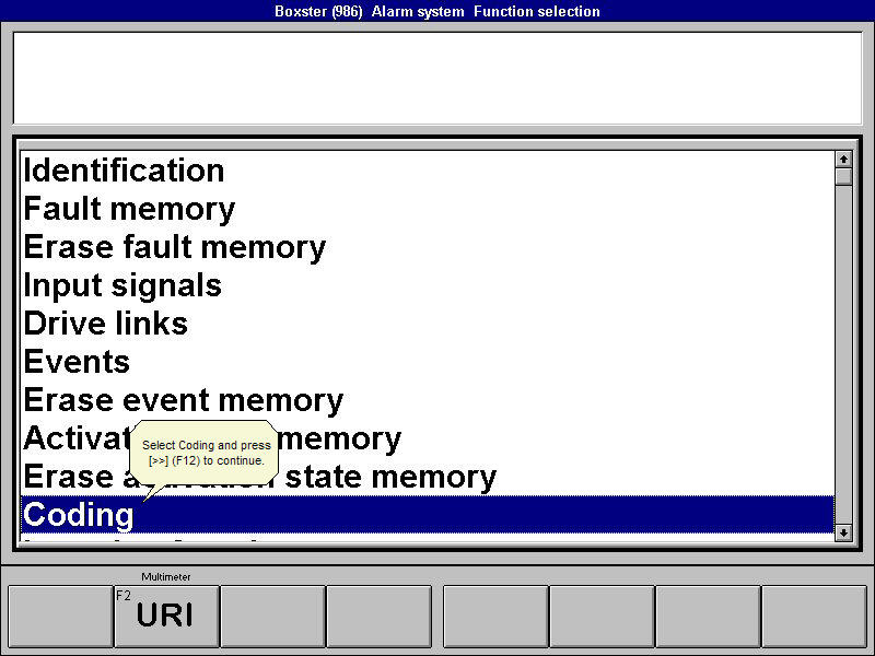

I was at the garage yesterday and he hooked up the PIWIS system but where is the option to set this? i could see it either, under alarmanlage ??
