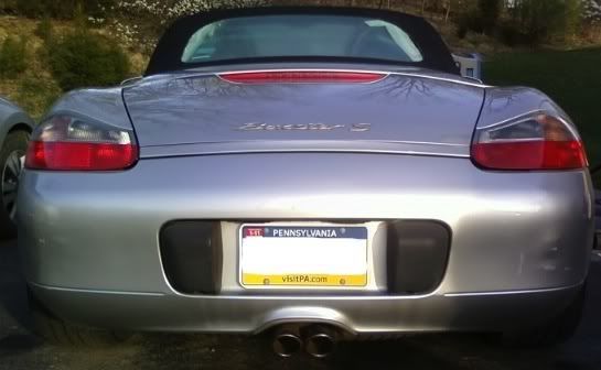

Here's a little comparo...excuse the messed up rear window (pic's from when I first got it). Stock:

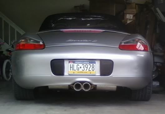

Modded. You can see the slightly misaligned mufflers, though it looks much worse in this pic due to the reflections. However you can also see how the bracket I made allows one to get the tips exactly in the right spot :)
