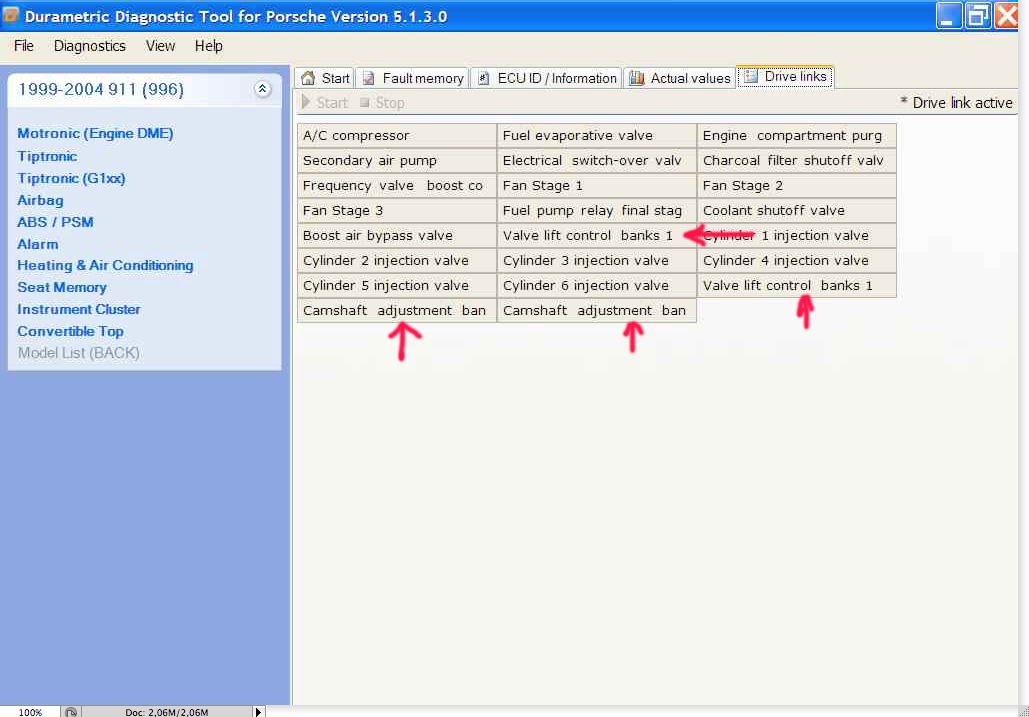

Hello Frank! If you use "drive link" you can select any of these solenoids (4 total) and in idle you should see the engine rumbling when one of the solenoid is selected. If there is no change in RPM either while selecting the valve opening solenoids or the cam advance solenoids, then you know one of the solenoid is not working.... This is the Durametric version 5 but I also saw it in version 6...

So its just a case of select the desired valve and if its working the engine should change rpm's/rumble. I was going to have a play last week but decided not to experiment with any of the drive links I'm not sure about.
Thats great, thanks mate.

You got it Frank! Of course I would not try it at high RPM but at idle you definitively see a difference once selected and start button depress....
