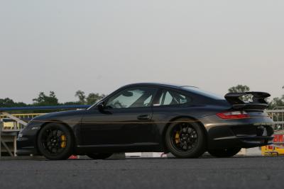

I run 18" CCW and Fikse 5s wheels on my PCCB equipped 997 GT3. The only thing that will rub will be the bottom of the rear gen 2 brake ducts if you have them attached. But only on compression of the rear suspension under load.

David, I was looking at the picture and was wondering who manufactures your rollbar and do you like it. Do you have race seats, if so what did you install? Thanks again!
The bar is a safety devices rear half cage , the seats are the nomex GT2 Porsche seats. The Safety Devices cage is distributed by Stable Energies in N.J. I got the removable harness bar for when we take the 3 on the road, undo four bolts, store bar and harnesses till needed again. There is a front half available also. It bolts to the rear shock towers and two plates that are welded to the round crossbrace under the rear seat area, not yo the floor of the tub. It gives you more room to move the seat back.
