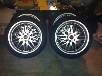

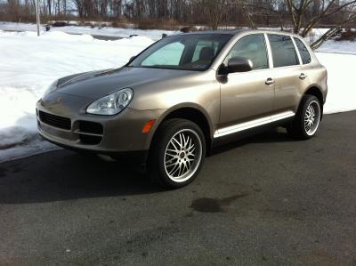

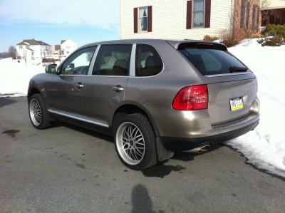

What do you think of my new wheels? I just put them on but it's too dark out for nice pictures. They are a staggered fit and I needed spacers to make them look really nice. Plan on lowering it next week. Any suggestions on springs??

The front offset for the wheels are +50, and the rears are +58. Not a perfect fit for Cayenne's, that's why I needed spacers. The tires are 275/40 in rears and 245/45 fronts.
I used 22mm spacers for the rears, and 15mm for the fronts. It's screaming to be lowered!
Because of the improper offsets, I had to use spacers these sizes for the wheels to fit over the brakes.

The wheels I have are +50 in front and +58 in the rears and I confirmed this with the seller. The fronts had to have spacers or they would not fit over the brakes. My wheels came with various size spacers so I used the second largest ones, 15mm. The spacers helped clear the necessary room and then some. I think I couldve used smaller ones, but the 15mm's made the wheels stick out just enough for that special look. The rears fit over the brakes perfectly but I added spacers to make them wider than the fronts, which makes it look pretty aggressive. I pretty sure my wheels were meant for 996's and such, hence the reason for needing spacers to make them fit and look perfect. Im not much of a wheel and tire tech, I pretty much just go with what works, and my local indy porsche guys told me that my setup is safe, and that it is common practice among their audi and vw guys.
