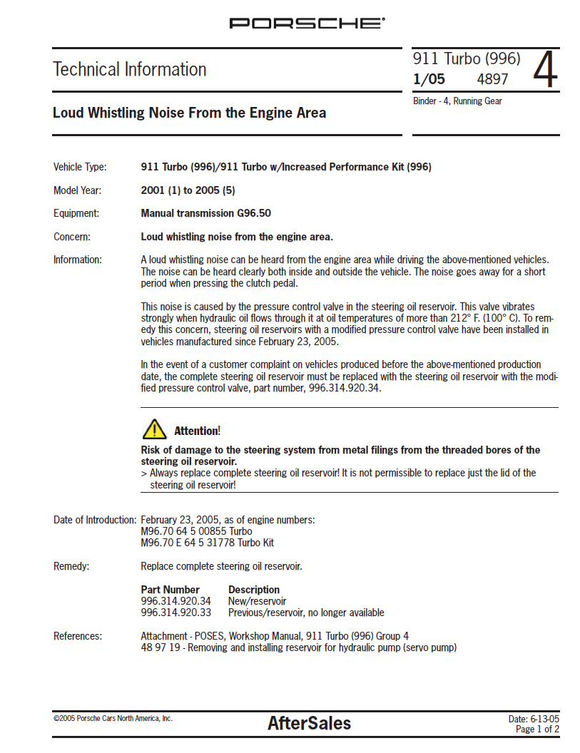

Look at this TSB. Depend if it goes away after depressing the clutch.... Also take a look at your steering reservoir level....

Thanks. The noise disappears when I press the clutch. Fluid is low when tested due to a leak at the front I've discovered. May also explain the spoiler issues. Car now booked in at my specialist. Cheers for the help.
Whistling was coming from the steering pump due to low level. Transfer of fluid from steering reservoir to clutch reservoir is due to a faulty slave. But I don't see why the spoiler can be part of your problem. I think it is a complete different story...
