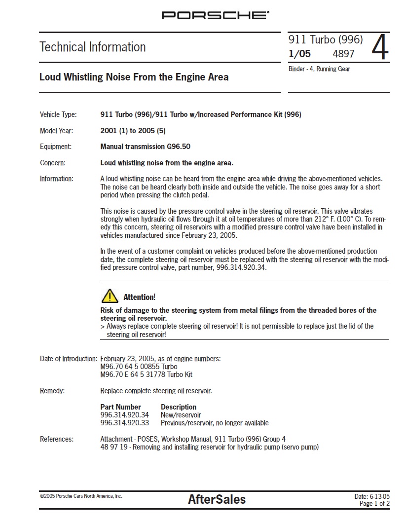

Cannot open the video but check your steering pump reservoir level and also take a look at this TSB...
