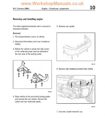

Go to the site on top of this picture and
you can get alot of information for a 996 car.
Looks like you might need some special tools.
You will need a transmission plate. Maybe
you could measure one and fabricate your own.
post-13642-0-67816500-1296608230_thumb.j
Paul

Hi Paul,
I followed your link, but it appears that this domain is for sale.
When was the last time you visited that site?

Here you go.
http://www.cannell.co.uk/Manuals.htm
This should keep you busy for a few hours.
I was told that it would take about three hours to drop the motor and the transmission.
Either way, you still need to remove the axles and the half shafts. My feeling is
that after you remove everything to drop the transmission, it is just
a few more bolts to drop them together. Here is a picture of the rear
suspension and you can see a lot of the parts that will need to be
removed.
