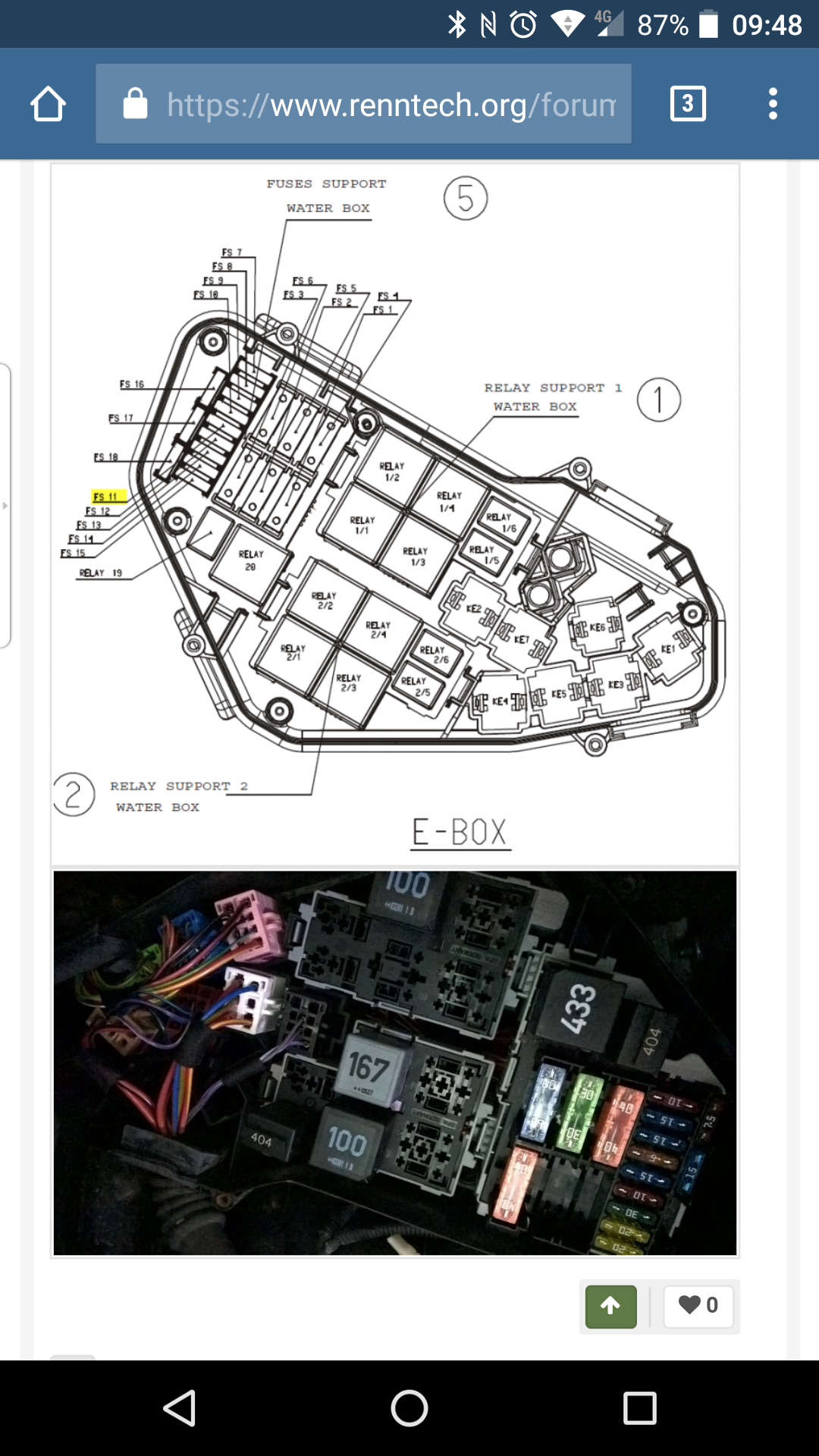

But if you have little to no mechanical knowledge I would not recommend you start diving into a fuel tank. Stalling after 30 seconds does sound like a left fuel pump issue because on start up both pumps run and the assuming you don't have low fuel level only the left pump carries on running. If the left pump is faulty the car will not run for long. Normally the car will know the pump is having a fault and kick the right pump to run after the key is cycled.
Easy check is to do, underneath the scuttle panel is the "Ebox" fuse box, remove fuse 14 left pump and run the car. Then replace and remove fuse 13 right pump, cycle the key between removal, see which pump it will run on tells you which pump is faulty.
If this has no effect it could be the filter is blocked or totally un-fuel related.
