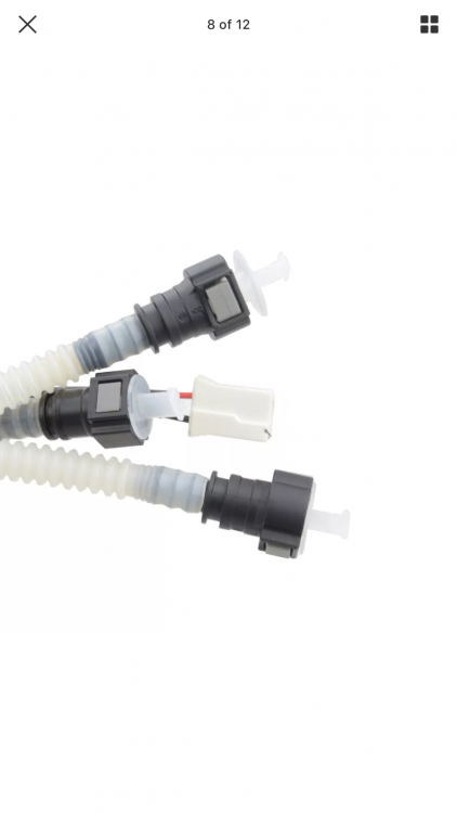

I change the driver side fuel pump (primary) last week end. If you need to drive the car and avoid to pay a towing, just remove the #1 pump relay in the engine compartment fuse box. You need a torx 30 because the relay is located in the hidden part right next to the firewall. If your car starts and stall in less than 30 secs... Remove the key, remove the #1 fuel pump relay, then restart the car. If the car still running after 30 secs, like me your primary fuel pump is defect. By doing this, the computer think there is no fuel on left side and run the secondary pump !!! I drove the cayenne about 60 miles with the second pump to the dealer to buy the fuel pump, small pipe and 2 seal because you need to open both side under the seat. The fuel pump have many pipe attached to it with different size and lenght to avoid bad connection. Two pipes are running from left to right. The job is not easy but you need to do it when the tank is almost empty or use a manual pump like me. Do it outside, the smell is horrible and take a tylenol. Dont forget to clean the fuel filter on the top plate driver side, I never seen so much black dirt in a small filter... I clean it 8 times in fuel bowl and reinstall it. I suspect dirt filter may cause the pump problem. To remove the bolt under the seat use M10 and they are very very tight and this is probably the biggest job to do. Then have a beer and congratulate you for saving 1,000$. I have all the pdf very helpfull if you want it, let me know.

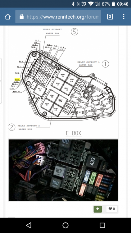

just a little bit off topic....to avoid the towing and the adventure when primary fuel pump fail's and you don't have the "magic" torx 30 to open the relay compartment in engine bay area,just pull the fuse # 14 located in the fuse box right next to the relay box. All you need is a penny to help you turn the plastic screws on the cover of the fuse box. You got the same result like pulling out the relay. It happend to me in the middle of nowhere and thanks to this forum,the internet browser from the smartphone,some verizon coverage and this trick to activate the secondary pump i was on may way and out of trouble in less than 15 min.

Info that might be useful for other users:
1. Where is the fuse box?
2. To reach the fuse box, you need to remove this lid:
3. To remove the fuse box lid, there are 3 screws:
4. And you are there:
