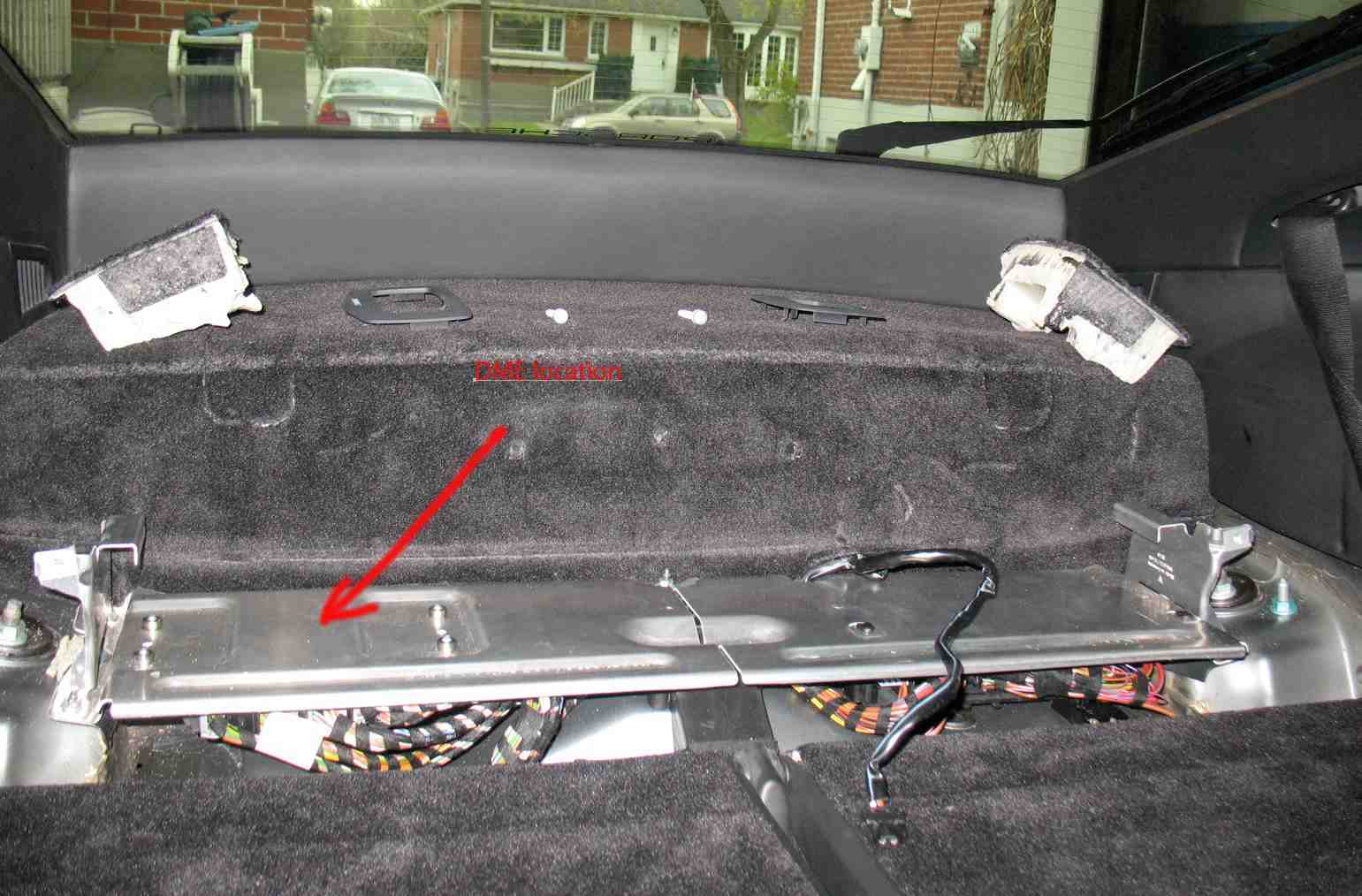

Also, it seems like I can probably check the knock sensor the same way. Where's the DME located and do the knock sensor wires route directly back to the DME? I know there is a box of some sort under the front driver seat?
Thanks again.
Can I help with this one.... DME location see pics. I cannot help you with the wiring since I only got the 2002 wiring diagram and on the 2002, the wires goes directly to the ECU from the knock sensors...
post-29683-0-41470900-1296494479_thumb.j
post-29683-0-69571800-1296494492_thumb.j
