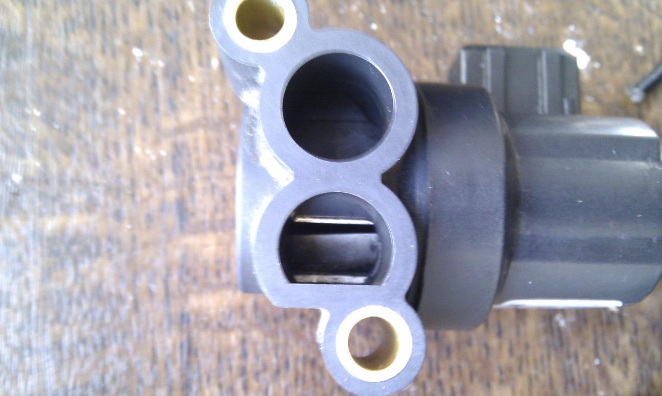

I HAD MINE OFF LAST WEEK AS I WAS CLEANING THROTTLE BODY ON THE WORKBENCH. SIMPLY CONNECTING A 9VOLT BATTERY TO THIS DEVICE WHILE IT WAS OFF THE THROTTLE BODY ,I WAS ABLE TO SEE THE "GATE" OPENING AND CLOSING
Ok i have tested the ICV with a 9V battery and it open and close so i suppose it works like it should.
post-33986-0-97825200-1296135972_thumb.j

You can cycle it (open/closed every second) with a Durametric so you can see if it's working or not. I was able to disassemble the solenoid pretty easily and a good cleaning did the trick for mine. There's a little pin that holds it together that can be pushed out carefully.

1. ICV? I have tested the valve with a 9 v battery and the flap opens and closes freely
