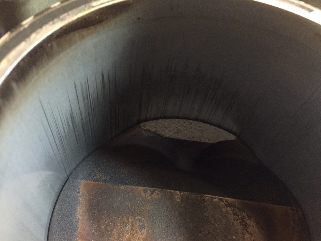

Guest porschesal
this is from a cayman with a very bad engine tick
But this doesn't help -- did you listen to the sound clip? Do you realize you're posting in a 996 forum? The Cayman doesn't even use the same engine.

@grown: The Cayman, Boxster, and 996 all use the same basic M96 engine.
@Jamesx19: There are diagnostic procedures can help identify the source of your problem. Those will likely include a compression test and borescope examination.
If those prove negative then you are likely looking at a transmission removal to inspect the IMS bearing.

I just put it up so you would know what it will look like when you use a bore scope
