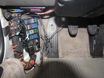

The car battery is fine. It sat in well below freezing temps for a week and cranked right up. I measured the battery as well and it's reading 12+ volts. The car has 105k miles on it. But I don't see how that would effect this problem. Unless it has a IMS in the lighting system. :o I pulled the fuse cover off and this thing apparently has been to Audio Sparks. (Audio Express) I sold stereos for years. And there reputation proceeds them! It appears there are wires running underneath the carpeting to the rear that are not stock and lots of other things going on. I know it has after market speakers in it. Because who ever put those in? Was impatient in mounting them and busted the grills. I have since replace those.

I'm going to call an a car audio installer that I used to work with that is very good at this. and see if he can figure out what the original installer was thinking when this was put in.
Randy

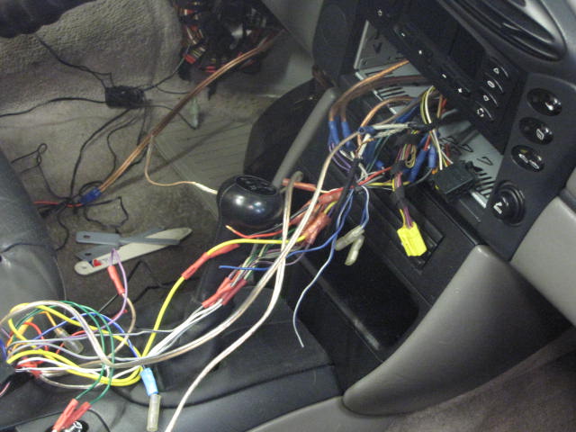

Well, Having the stereo pulled out and re-installed by someone that new what they were doing. Didn't fix the problem. But figured it was worth a try. But all and all, was glad I did. This picture is a lesson on how not to install a stereo. Whom ever did this install needs to find a different line of work. But it's all cleaned up now and the stereo sounds 100% better.

Yep, pretty unbelievable. But like I said. I sold stereos for years and that is not the first time I have seen something like that. :censored:
Just as a side note to people who may see this thread. There is no reason on this planet to use 12 GA wire to the speakers from a head unit like original installer used. There isn't near the current coming from it to justify it. 16 GA is fine. If you're coming out of a fairly high powered separate amp, then maybe?
