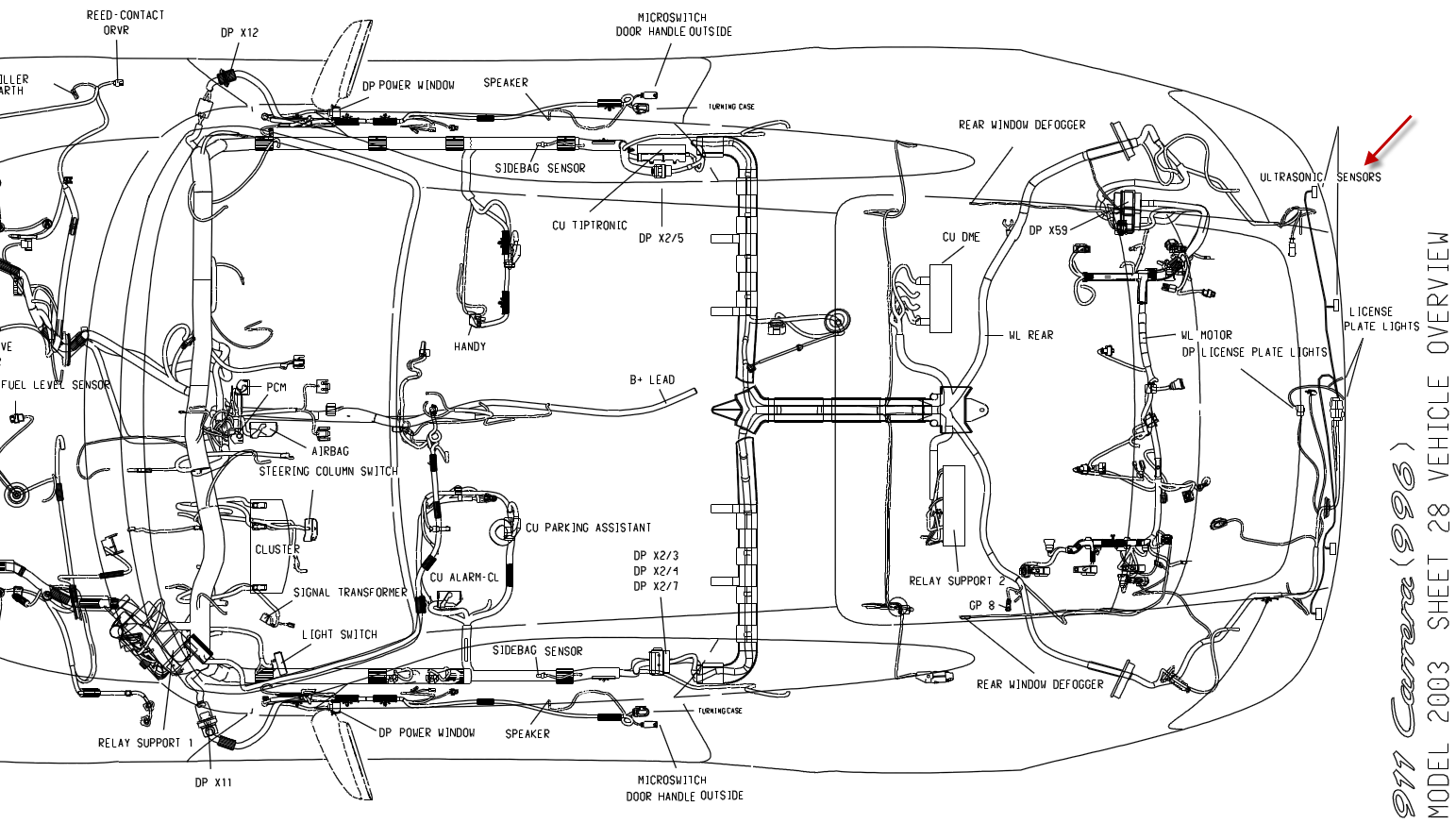

Perhaps this will help some - the factory routing (all Porsches have factory custom wiring harnesses).

Thanks for the response and for welcoming me to the forum! So it looks like there is an access point on the right hand side of the car, I will have to investigate.

Loren wrote: "Perhaps this will help some - the factory routing (all Porsches have factory custom wiring harnesses)"
That's great, very helpful, something I have actually been looking for, but its apparently hidden behind some javascript popup. I would like very much to have the file, and be able to print it etc. The help says to use the download tab at the top of any page, and I see no downloads tab. Searching in the downloads listing under the documents menu for "sensors" and "sensors.png" brings no joy. Does the help mean "document menu" when it says "downloads tab"?
