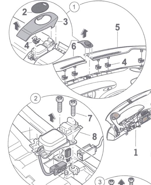

To my knowledge it does fit and do you mean the alarm light on top of the dashboard?
that is a black plastic cover you pop off (carefully) then you will be able to lift the light up and disconnect the wire (keep hold of the wire or stick it to something cause it is hard to get back)

Even easier with a drawing

Sorry guys i mean the harzard light switch ( in holland we call these alarm lights) my bad... so i want to remove the harzard light switch.......
Press hazard-warning button so it projects out. The button can be pulled off by hand. If needed, a small common screwdriver can be used to help remove the button. With the button removed, access to the switch is available. On either side of the switch there are two locking tabs. With thumb and forefinger squeeze the tabs and simultaneously pull the switch out using long nosed pliers.
Remove the hazard-warning switch plug from the instrument cluster by moving the locking tab sideways toward the center of the car and pulling the plug down and out of the cluster assembly.
