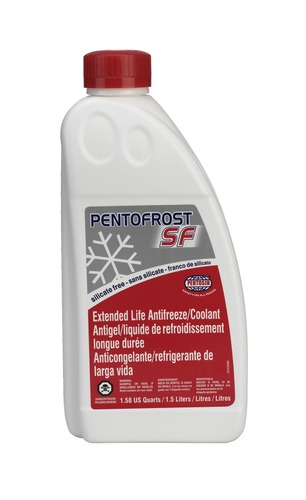

Porsche brand coolant is just Pentosin G12 (same as the VW labelled stuff). You can buy the Pentosin PentoFrost SF at OReilly Auto Parts. This is pink and is the same as what comes in the Porsche jug.
If it actually is the same, and I do not know that as a fact, it is also around $13 per 1.5L container, so it also costs more (at retail) than Porsche coolant.
It has a reference to a Porsche coolant p/n (now superseded by another p/n)
http://bd8ba3c866c8cbc330ab-7b26c6f3e01bf511d4da3315c66902d6.r6.cf1.rackcdn.com/Pentosin_Antifreeze_Pentofrost%20SF_Oct12.pdf
It seems to be legit but I agree it's either more expensive or not much cheaper than the genuine coolant where you can get from porschepartshub.com at a very reasonable price. I'll stay with the genuine fluid just to be safe.
Edited by Ahsai
Not cheaper at my Porsche dealer. EVERYTHING is above MSRP there.
+1 on Ahsai's comment.  There are also other online retailers (non dealers) selling it for around $35 a gallon as well.
