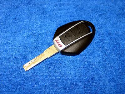

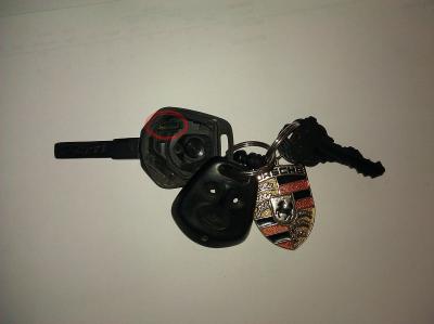

I am at the stage where I have to get a new key and fob. I would like to use one of the new 911 key fobs or even the GT both have been cited as possible replacement FOBs. I lost my original boxster key and the spare only remotely opens the doors 20% of the time so a new one is in order regardless.
The single dealer we have here wants $291 for the original black FOB (my old one pictured) $42 for a blank key (which they can't cut??) plus $150 to reprogramme the new key (he did say I can BYO FOB as long as i have the code number)
$483 plus I have to get someone to cut the key. I know I can get the standard black fob online for about half that cost, though i would prefer the 911 or GT FOB if it works.
When I asked about the 911 or GT FOB he said NO
If anyone is using a GT or 911 FOB on a Boxster 2000 can you let me know or point me in the right direction.

If you have a two button remote key I do not know why the two button 911 FOB would not work. Tool Pants might know for sure?
You can swap the transponder pill from the old key and the metal blade from the old key and not have to pay for any programming or cutting.
It is documented here and in a Porsche TSB.
00Boxster,
Swap will work fine, I did mine a few months ago. As Loren stated, just swap over the circuit card and pill and viola, you have a cool looking key fob. When you press the button to open the locks the "911" on the remote glows red. Kinda neat at night but then it doesn't take much to amuse me :rolleyes:
00Boxster,
I actually need to get the 911 key with the guts in it (transmitter) as I have lost my original key.
Will the guts from the 911 work or do I still have to order a standard boxster FOB head and then transfer it to a 911 case?

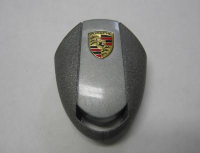

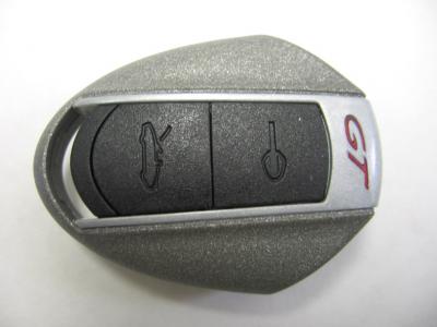

- Yes the 2 button remote is the same for the 996/986. However, you need to make sure you have the IPAS codes or the dealer cannot reprogram. You can buy new ones from places other than the dealer but make sure you get the tags that come with as they have the codes necessary for reprogramming.
When the dealer does the reprogram will they have to do both my old spare key and the new key? IE Will I get charges 2 x $150
- Yes, they will need to reprogram all the keys at once as reprogramming erases all the old info. labor charge is by the hour or partial hour if you exceed one hour. Most shops will have a one hour min. It only takes about 15 mins to program if the tech doesn't have any problems.
Once you get the remotes back home you can pop the covers and swap the guts to your new FOB. BTW, people are funny about putting incorrect model designation parts on Porsches... a GT cost about 10 times what your car costs... Just saying... I sure don't care.
Good luck, Tom
All authorized Porsche dealers/OPCs have access to IPAS codes.
True, but a new key comes with a tag that has a 24 character code. (It may not be IPAS but that is what the dealer told me) If the key has been previously programmed by the dealer then you will most likely not need the numbers for the remote. When I had mine done recently the service manager told me to hang on to the tag with the number. Sometimes the 24 digit code is dropped from the computer and then cannot be reprogrammed. If he buys a key fob off of eBay, RT, RL etc. and doesn't get this tag, he will have wasted his money.

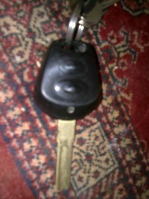

Can any of the following info on the back of my fob (see Picts) be used to program it to my car so the button unlocks the door. The pill works as I swapped it from another working key.  I don't have a tag for this remote. Thanks!
Edited by Canada-Eh
No, you have to have the original tag to program the system.
Hello, I can learn all key fobs porsche 996 and 986 Boxter series ,I can do this without 24 character code , I can learn aslo used and new key fobs .I do this gratis for somebody here which start believe me that I can do it. I want  to do this as demonstration of my know-how.
