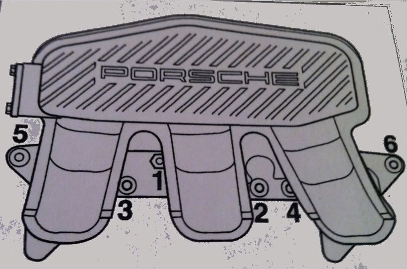

I recently changed my change over valve and accessed it from inside the cabin. You have to remove keys from ignition, disconnect negative lead to the battery and remove the passenger seat, then rear carpet covering then the access aluminum panel. You then remove serpintine belt and then alternator. The change over valve is directly behind the alternator. To get the alternator out you also have to put the top in service position and open up main engine bay to gain access to the main electrical leads to disconnect from alternator. It wasn't difficult but a lot of work.
I would do all over again by removing the fuel intake manifold. You will need to remove the throttle assembly (tube bewteen manifolds that connects the throttle body). You can remove the six bolts (M6 x 16) to the intake manifold in any order, but on re-assembly you should reconnect the manifold and bolts in the sequence below to 7 ft.lbs torque.
The other reason I would approach this way as it allows to better inspect vacuum hoses. You can also give the throttle body a good cleaning. One reason why I went from behind the passenger seat was to also replace my serpentine belt.

Hi,
Thanks for the information. I still haven't done it. I opened the panel behind the back seat. I saw the alternator. It seems it's more difficult removing alternator than removing
the intake manifold. I think I can remove the bolts 1-2-3-4. For the bolt #5, it's under a rigid hose and I think the hose is connected to the air oil separator. The hose is in the way.
I disconnected the hose connector at the oil separator end but seems I can't clear the path so that I can remove the bolt #5. Any suggestion on this?
For the bolt 6, I think I can remove it from the panel behind the back seat.
The space around the manifold is just too tight and I am very nervous about touching any hose in the area. I am afraid that I might break the hoses.
