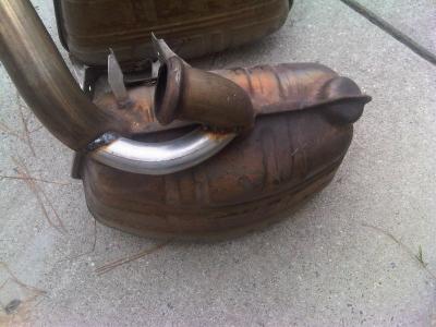

I got this done at my local muffler shop for 60 bucks (both mufflers)....sound is awesome with no droning....
post-65806-0-34193000-1326292982_thumb.j
Edited by PESuazo
This the mod i did some years ago & they sound great. Basically it,s the same a genuine sports exhaust from porsche but without the valve & actuator. Only problem with this mod is it can be a bit too much if you do long runs.

I did a similar modification to my stock cans as shown in post#9. Inexpensive, excellent exhaust note, no drone, not excessive during normal acceleration, does not need a computer reflashing, does not cause a CEL illumination. And it was cheap and easy!
